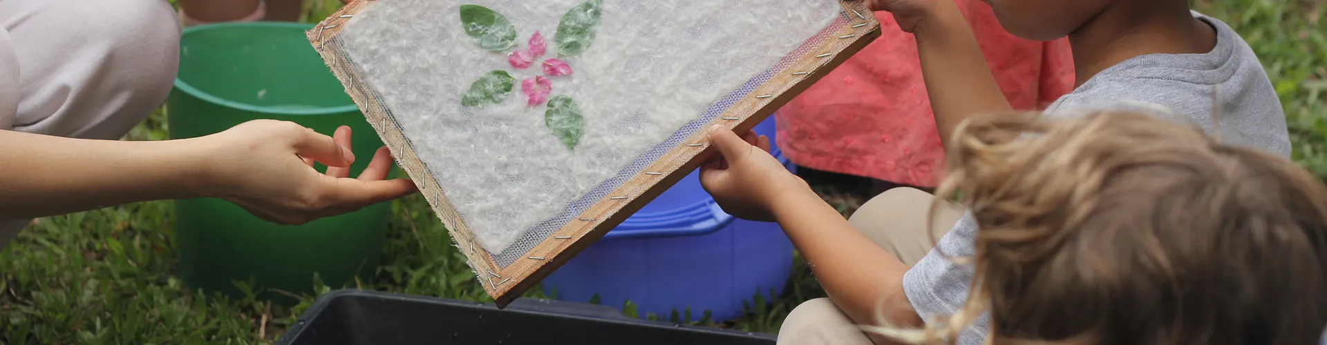

Instructions
• Step 1 - Cut or rip up scrap paper into small pieces.
• Step 2 - Put the strips into the bowl. Cover with warm water. Soak overnight.
• Step 3 - Put mixture into the blender. Half fill the jug with water. Make the pulp.
• Step 4 - Put the pulp into the washing-up bowl. Mix with your hand.
• Step 5 - Put the sieve into the bowl. Allow the pulp to settle over it. Gently lift it with a layer of pulp covering it. Allow water to drain.
• Step 6 - Put the paper on top of a tea towel. Place another towel on top and pat the pulp to soak up excess water. Peel the tea towel off slowly.
• Step 7 – Carefully remove the paper from the sieve.
• Step 8 - Flip over onto another tea towel. Cover with another tea towel and dry.
• Step 9 - Peel the tea towels off slowly.
