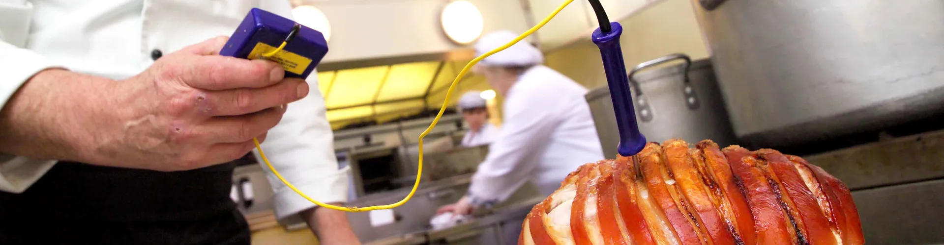

Micro:bit food temperature probe design project
Creating a working prototype of a food temperature probe
This activity tasks students with using the micro:bit to develop a prototype for a food temperature probe that will warn people when their food is too cold.
